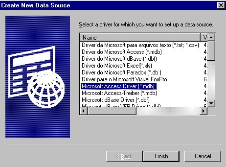

The first step is to create a data source. This requires that you locate the Microsoft ODBC drivers in the Control Panel of your computer. In some operating systems, the ODBC drivers are located under the Administrative tools.
Open the ODBC drivers dialog and click "Add."
Locate the Microsoft Access driver.
Click "Finish" and then enter "mydata" (or any name you choose) for Data Source Name.

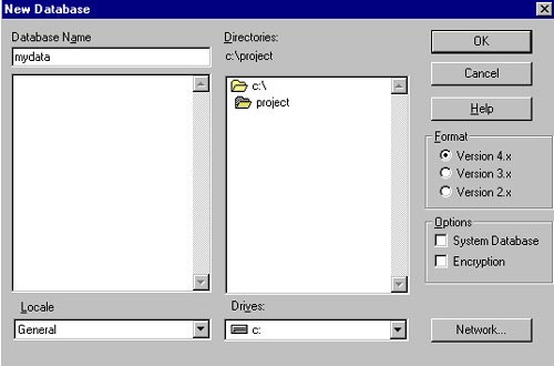

Click the Create button.
Enter the name "mydata" for the database name and make sure that the directory c:\project is selected for the directory name.
Click "OK" and the Access database and data source creation process are completed.

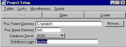

Proj. Parent Directory: c:\project
Proj. Name Directory: test
Database Server: ODBC
Database Login: mydata
Click the Create button to begin the project creation process.

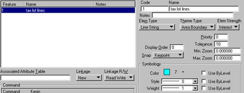

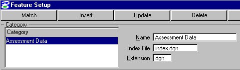

The first step is to define a category. Since we have some example tax parcel ESRI .shp data delivered with MicroStation GeoGraphics, the category will be called Assessment data. Enter the data listed in Figure 4 and click "Insert" to create the new category.
With the category highlighted, we will proceed to the feature area of the dialog. Enter the feature code and name, then click "Insert."
With the feature highlighted, enter the element type, theme type, and symbology information. Element and theme type are particularly important to the import process.
Click "Update" to add this information to the feature definition.

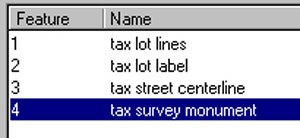

Repeat this process and create features with the following parameters:

When you are finished, click the Commit button. You will have a list of features like those in Figure 7.

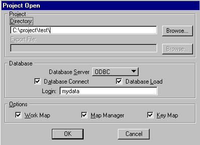

Go to the Project > Open dialog.
Enter the following in the dialog:
Directory - C:\project\test\
Database Server - ODBC
Database Connect and Database Load (both checked on)
Figure 8
Login - mydata
Click "OK" and, if prompted to overwrite work.dgn click "OK" again. You should be in a design file called work.dgn.

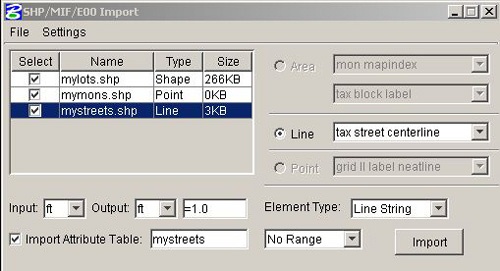

To open the Import/Export dialog, go to File > Import > SHP/MIF/E00.
In the SHP/MIF/E00 Import dialog, click File > Select Import file.
Locate Mylots.shp, mymons.shp, mystreets.shp in the \Bentley\program\geographics\prj\mytown\imp directory. Multiselect all three files and click "Select."
The three files will now be listed in the SHP/MIF/E00 Import dialog (Figure 10).
For each of these ESRI .shp files, the correct feature must be selected and the Import Attribute table toggle must be checked on in order to import the attribute table data. If the toggle is left off, only the graphics will import. Highlight each shape file individually and review all of the feature settings. Mylots.shp is listed as a type shape so the Area theme type is enabled. The area theme type must have two features available-in this case tax lot line and tax lot label-to import the ESRI .shp file correctly.
Enable the Import Attribute table option to import the database linkages. Mymons.shp is a type point, so the Point theme type should be enabled and the tax survey monument is listed as the feature.
Enable the Import Attribute table option. Mystreets.shp is a type Line, so the Line theme type should be enabled and the tax street centerline is the available feature.

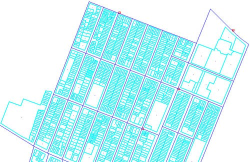

Click the Import button to begin the import process. The result should look something like Figure 11.

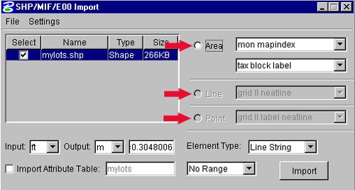

Simply connect to the project, open the File > Import > SHP/MIF/E00 dialog and pick the file to be imported. Turn off all of the radio buttons next to any features selected - next to the words area, line, and point.
Click the Import button and the graphics will be created in the design file.
