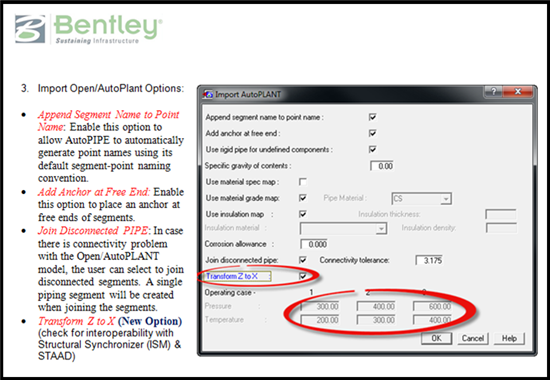

How to Import ProStructures into AutoPIPE?
Please see the following web site to export a model from ProStructures to ISM then to STAAD.Pro:
http://communities.bentley.com/products/structural/w/structural__wiki/modeling-and-node-generation-best-practices.aspx
Then see refer to PIPELINK_tutorial.pdf  for detailed information about importing:

Instructions on flipping the Auto / Open Plant model to match ISM are copied below. Note the transform switch was added to APIPE V9.6.x.x SS5.
Import and Export
