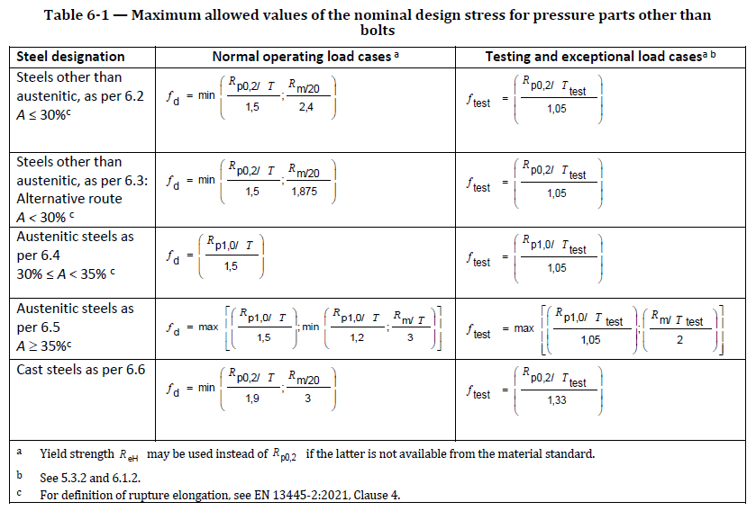

How are Allowable Stresses (nominal stresses) calculated for a material in AutoPIPE Vessel?
AutoPIPE Vessel calculates allowable stresses (nominal stresses) according to the requirements of various design codes. The allowable stress can be manually changed using user-defined values of Safety Factors.
For details on how to input a user-defined material factor of safety to modify the allowable stress, refer to KB article [KB0031424].
EN 13445-3:
Example 1:
Material: SA516 Gr 60 (Carbon Steel, A = 0%)
Example 2:
Material: A182 Gr F316L (Stainless Steel, A = 28%)
