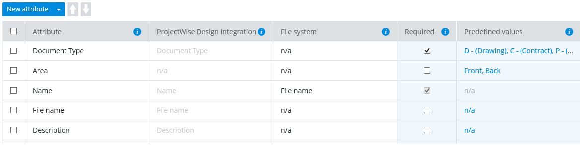

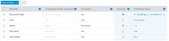

Required Transmittal Attributes and Predefined Values
Starting with this release, environment attributes for documents in a transmittal cannot be left blank (they must have a value) if those environment attributes are marked as required in ProjectWise. This means that you will not be able to issue a transmittal if a document listed in the transmittal is missing some required attribute values. A required attribute will have an asterisk next to it in the transmittal, indicating that it is a required field. Also, when an environment attribute in ProjectWise is configured to have a predefined list of values, those attribute values will be available for you to select from when defining attribute values for documents in a transmittal.
As part of this enhancement, two new columns have been added to the transmittal attribute list in the portal settings: Required and Predefined values. For the ProjectWise environment attributes that are included in the transmittal attribute list, any required environment attribute will have its check box automatically checked in the Required column, and any environment attribute that has a list of predefined values will have its values automatically exposed (comma separated) in the Predefined values column.
Note: The Required and Predefined values columns can also be applied to portal-only document attributes (attributes that are manually added to the transmittal attribute list in the portal settings). Specifically, you can turn on the check box in the Required column and/or enter a list of predefined values in the Predefined values column for any portal-only document attribute whose File system attribute is set to n/a. (A portal-only document attribute will always have the ProjectWise Design Integration column set to n/a.)

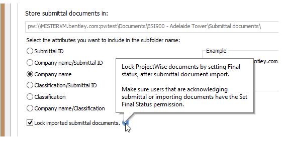

Automatically Set 'Final' Status on Imported Submittal Documents
For ProjectWise Deliverables Management connector for ProjectWise Explorer users, a new setting called Lock imported submittal documents has been added to the Deliverables Management Settings dialog, Storage tab. When on (the default), importing submittal documents (whether by acknowledging the submittal or by manually importing a submittal's documents) will automatically set each imported document's status to Final, assuming that the user who performs the import has their Document > Set final status user setting turned on.

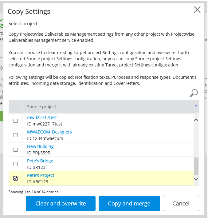

Merge Settings from Another Project
When copying settings from one of your organization's projects to another, you can now choose whether you want to copy all settings (as in previous releases), or whether you want to copy over only the settings that are different.
  • Clear and overwrite - This option erases your current project settings and replaces them with the settings from the selected project.
  • Copy and merge - This option keeps your existing settings, and only copies over any settings that are different in the selected project.
