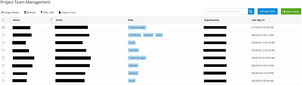

Navigate to the Connected Project using your Browser: click Settings or click Manage Members
This will bring up the Project Team Management page:

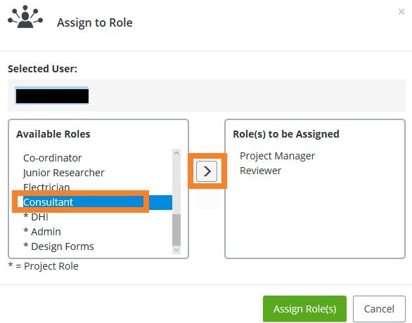

Some User(s) may have one or more Role's - To Assign a New or Remove a Role from a User - Select the User: Add from the Available Roles or removed from the Role(s) to be Assigned by highlighting.

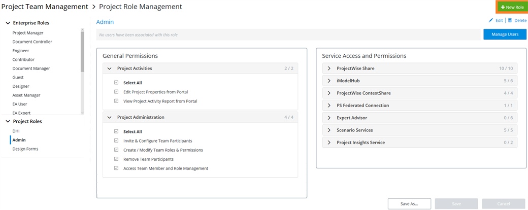

Permissions for a User on a Project can be check & Edited from Manage Roles:
A Connect Administrator will likely have all the permissions, whereas a User(s) depending on his\her Role(s) may have different permissions
TIP: A Custom Role can be created if required by clicking "New Role"

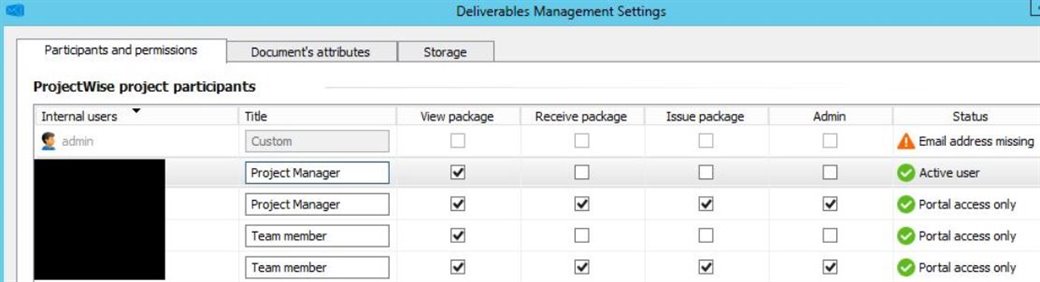

2nd scenario: User is a CONNECT Services or Co-Admin & is set up as a Project Manager for the specific Project but Design Forms is still greyed out.
- Verify the information on the Connect Portal
- Launch ProjectWise Explorer
- Navigate to the Connected Project & expand the node
- Right click Deliverables Management (ProjectWise Deliverables Management connector for ProjectWise Explorer needs to be pre-install)
- Click Settings
This will bring up the Deliverables Management Settings page:
From the above - Two User's are Project Manager however one has only View package enable.
Reason: A User can be part of one or more group which was getting his rights overwritten
Solution: Removed the User & add him back
Important: How to manage permissions for ProjectWise user groups/lists or individual users?
When you set permissions for a ProjectWise group or user list, all members of the group or user list inherit those permissions. If a ProjectWise user is added to the internal participants list twice (once as an individual user, then again as a member of a group or user list), the permissions set for the individual user will override the permissions the user inherited from the group or user list they are a member of
