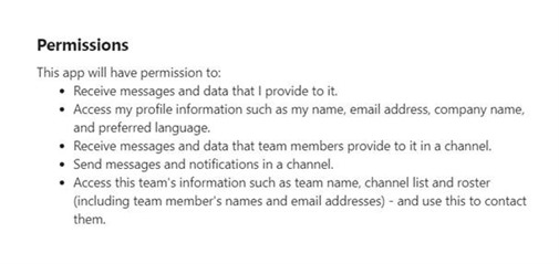

The application also uses Microsoft Teams authentication to access information in Teams that is required for:
The application requests the following permissions from Teams:
