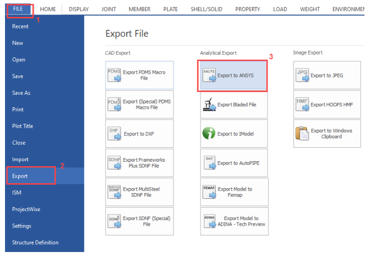

Steps to follow to export SACS into ANSYS as below:
1. I use Sample 01 model as an example. Open model in Precede. Go to File Tab

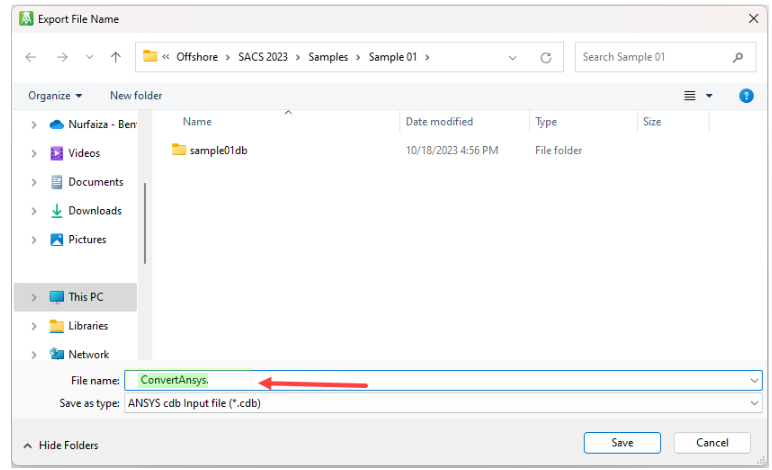

2. Give it a name > Save

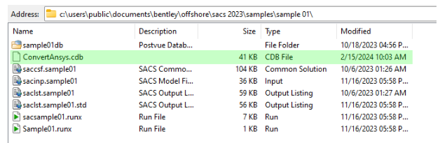

4. In SACS Executive you will see the Ansys file created.
The .cdb file is ready for Ansys. Make sure the file size is more than 1KB for successful conversion.
