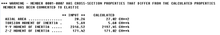

Hello, Bentley I am Performing a collapse analysis in which I get the next particular warning, I would like to know the meaning of this,
Answer:
when we work with sections that were input manually in sacs we can face this warning that advises us that the properties sections calculated by SACS don't match with the sections input in PRECEDE,
triggering that all sections with this characteristic will be considered as elastic, this could be the same as including this section or group with the use of the GRPELA card (Elastic Member Group).

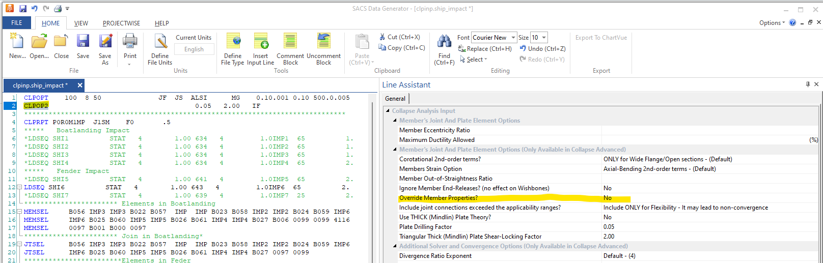

If you intend to override the member properties calculated for SACS and take into account the properties input using Precede, you have to set this in the card CLOP2
