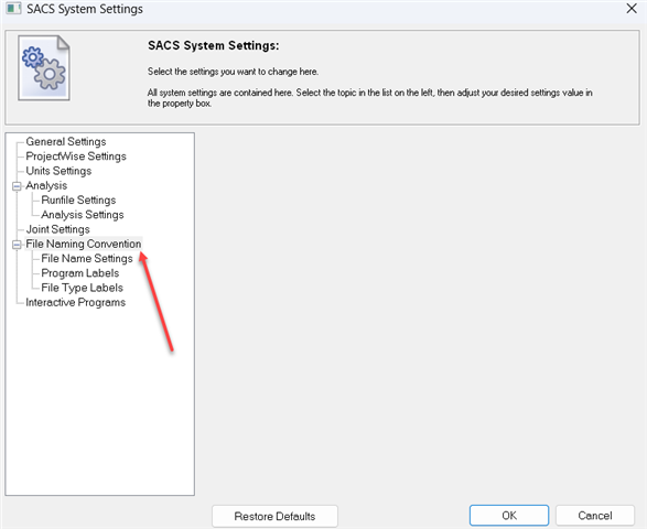

How to save files in right format for easy access while building analysis run file without looking for "all files"?
Go to SACS Executive under SACS System Settings/File Name Settings. Set the File Naming convention there for automatic recognition of input files.
