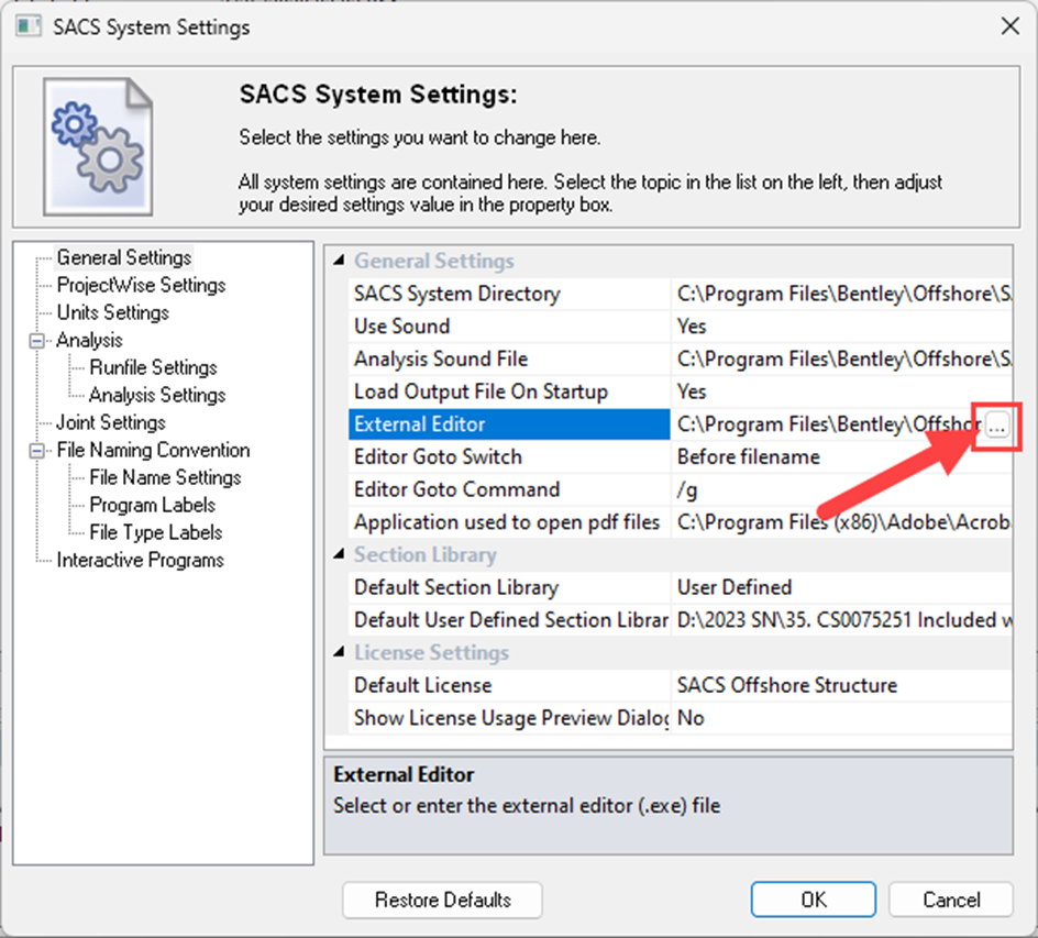

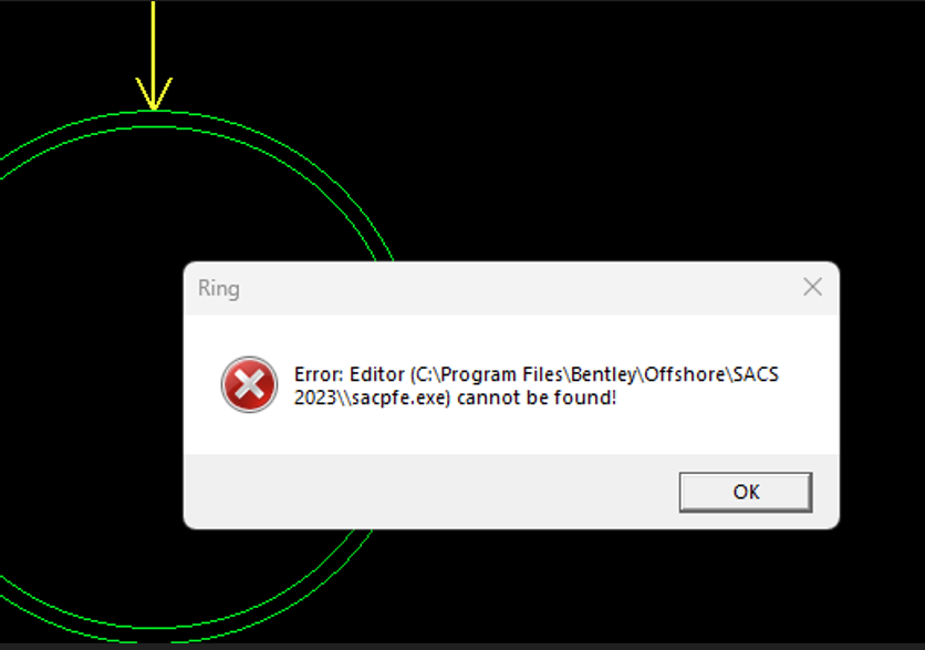

In SACS V23 the default external editor is set as Notepad and in the installation folder no sacpfe.exe file is found. How can I change the settings of SACS program to use the program file editor?

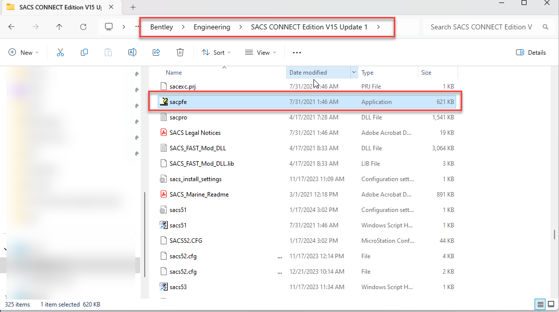

In case the sacpfe.exe file is not available in the SACS V23 installation folder then, you can use the sacpfe.exe executor of whatever previous version of SACS and paste it in the pathway installation on version 2023.
once the file sacpfe.exe is located, you need to copy and paste in the pathway installation of SACS 2023 and then change the editor in the setting of SACS
Below snap can guide you on the setting. This will work for SACS V23 also.
This resolves issues using applications like Ring Stiffener  application, which needs the use of this application to show the result in the analysis of Rings Stiffeners
