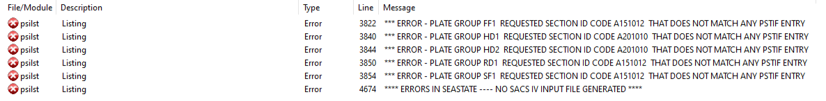

While creating the PSTIF card for angle section, is it mandatory to give details for the properties? I found a System Error, but I couldn't resolve it.
1. Plate groups requested section ID A151012 and A201010 that does not match the PSTIF entry.

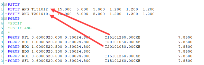

2. The stiffener defined in PGRUP cannot read SECTION line. The stiffener properties should be defined in PSTIF line as below sample:
Note that the value being used in the definition is only as sample. You need to use the correct value for your design.
SACS outputs a system error because the PSTIF properties are not defined correctly.
