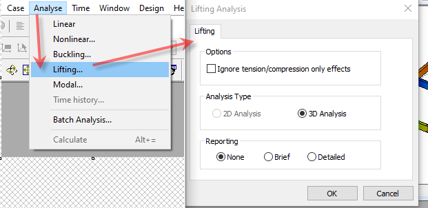

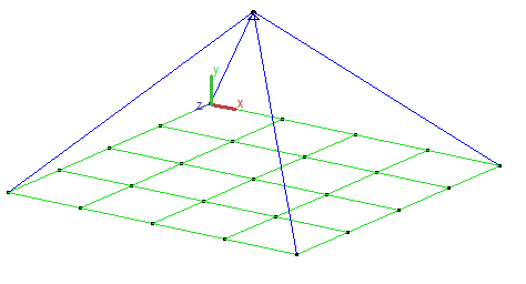

The frame structure needs to be lifted from one or several points How to perform lifting analysis in Multiframe?
In order to perform Lifting analysis go to Analysis | Lifting:
Lift analysis is designed in the same way as normal analysis apart from joint restraints in Multiframe. For lift analysis, pin restrains(Rx, Ry, Rz, can be combined with one or multi-direction’s rotations) can be applied only at the lifting points.  During the analysis, some stabilizing springs will be added automatically without needing to do this manually.
