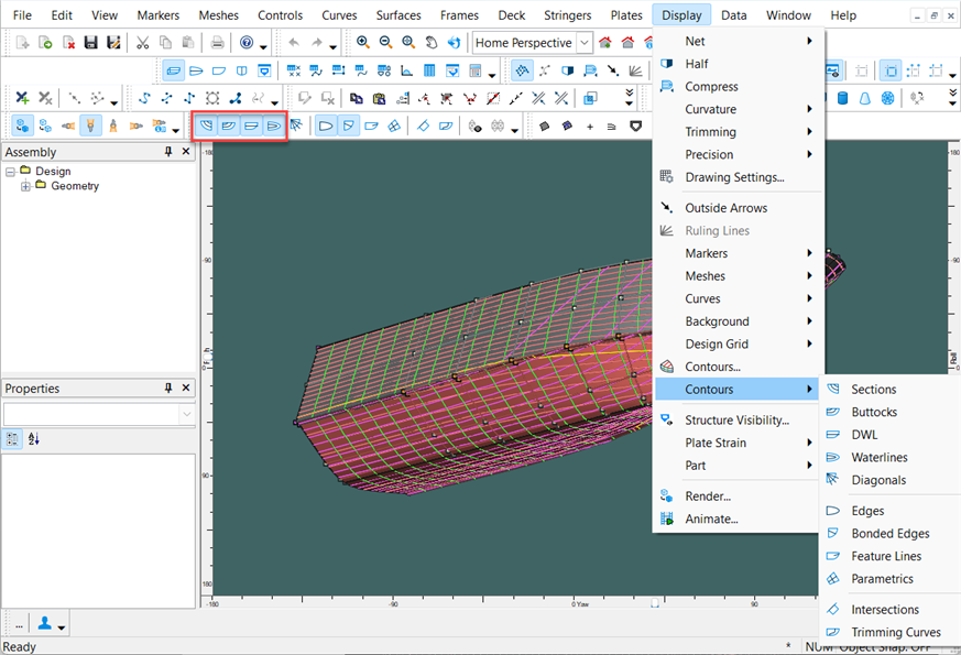

Make sure your model's contours are turned on. Go to Display | Contours.
You may change the spacing under Data | Design Grid.

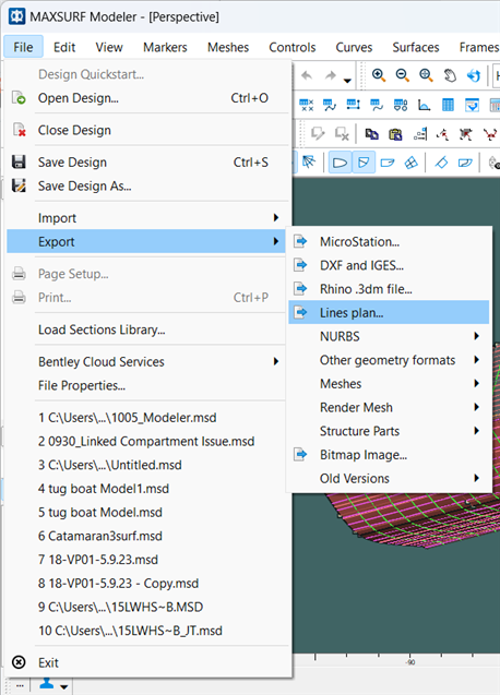

After that, you can now export the lines plan. Go to File | Export | Lines Plan.
Please read about it on the Maxsurf Modeler Manual page 346 - Export Lines Plan.
