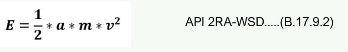

First, we have to calculate the energy results of the type of vessel using parameters like velocity and mass provided by this code. Using the recommendations in the API, we have the following formulation:
Where,
E = Is the kinetic energy of the vessel
a = Is the added mass coefficient, 1,4 for a broadside collision, 1,1 for a bow/stern collision
m = Is the vessel mass
V = is the velocity of the vessel at impact

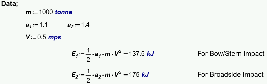

For this case, we are going to work with a vessel mass of 1000 tons and with a velocity of  0.5 mps

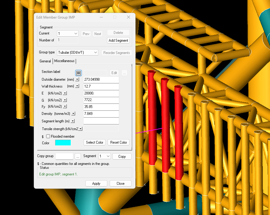

Once you have the kinetic energy for the vessel we have to propose a maximum dent for the contention elements, in this case, we'll propose a 25% dent for the element, you can work with Table B.17.1 of API  in which we have some recommendations to reach a 12.5% 16.7%  y 25% depending of the diameter and thickness sections.
For this sample, our model has a 273mm x 12.7 mm section
with this data, we will suppose a deformation of 25%, and with this, we can get the force:
As you can see, for the Broadside load we have 854 kN, which is the reason sometimes we set 1000 kN as an impact force. With this value applied to the structure, the software will start the deformation, and with this, the absorption energy process will be registered in the collapse log file.

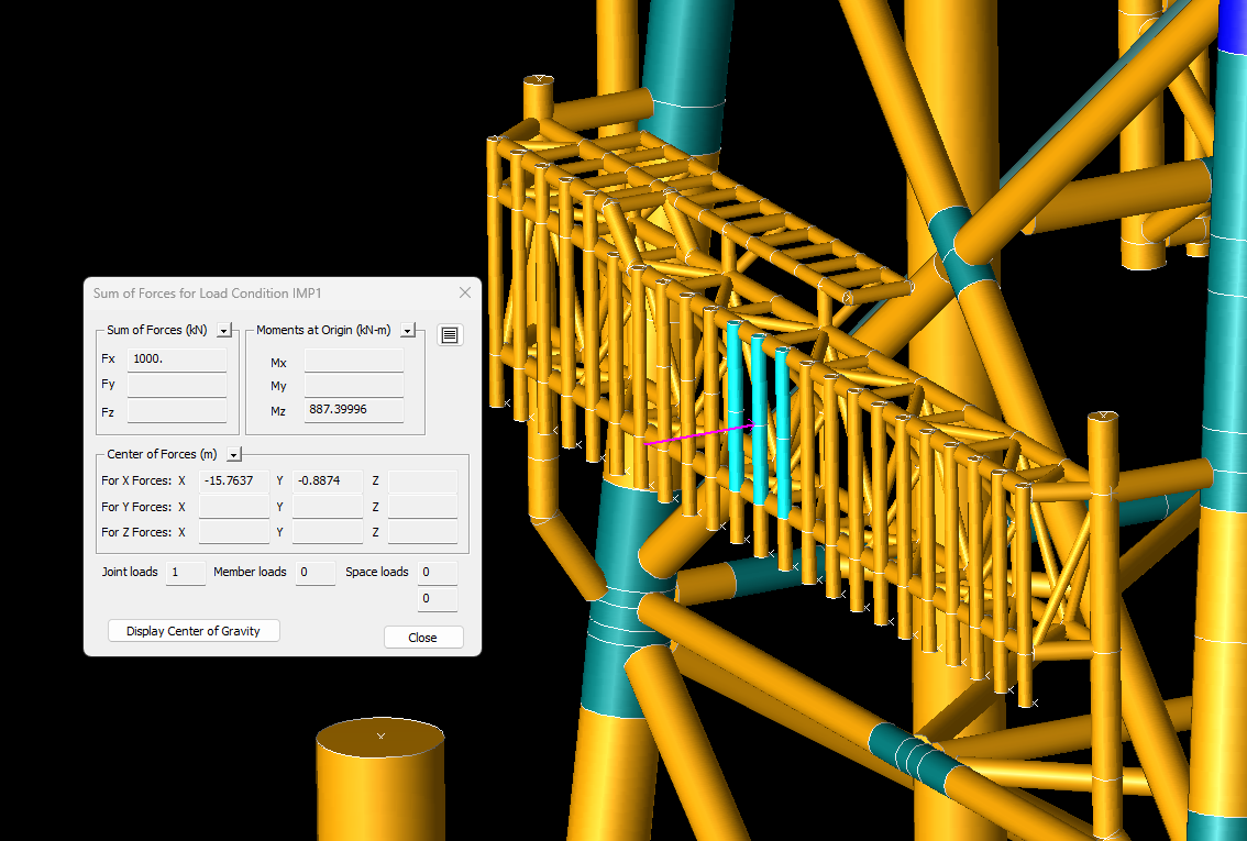

  1. Apply a load in the study zone with a value equal to 1000 kN in the direction that you want and run a simple linear static analysis
  2. Get the impact joint displacement (U) from this simple linear static analysis
  3. Calculate the stiffness of the structure (the slope of the linear line in the above figure) as  Klinear= P/U
  4. Calculate the absorbed energy for a given load F:  E = 0.5 x ( F^2 / Klinear )
Note:

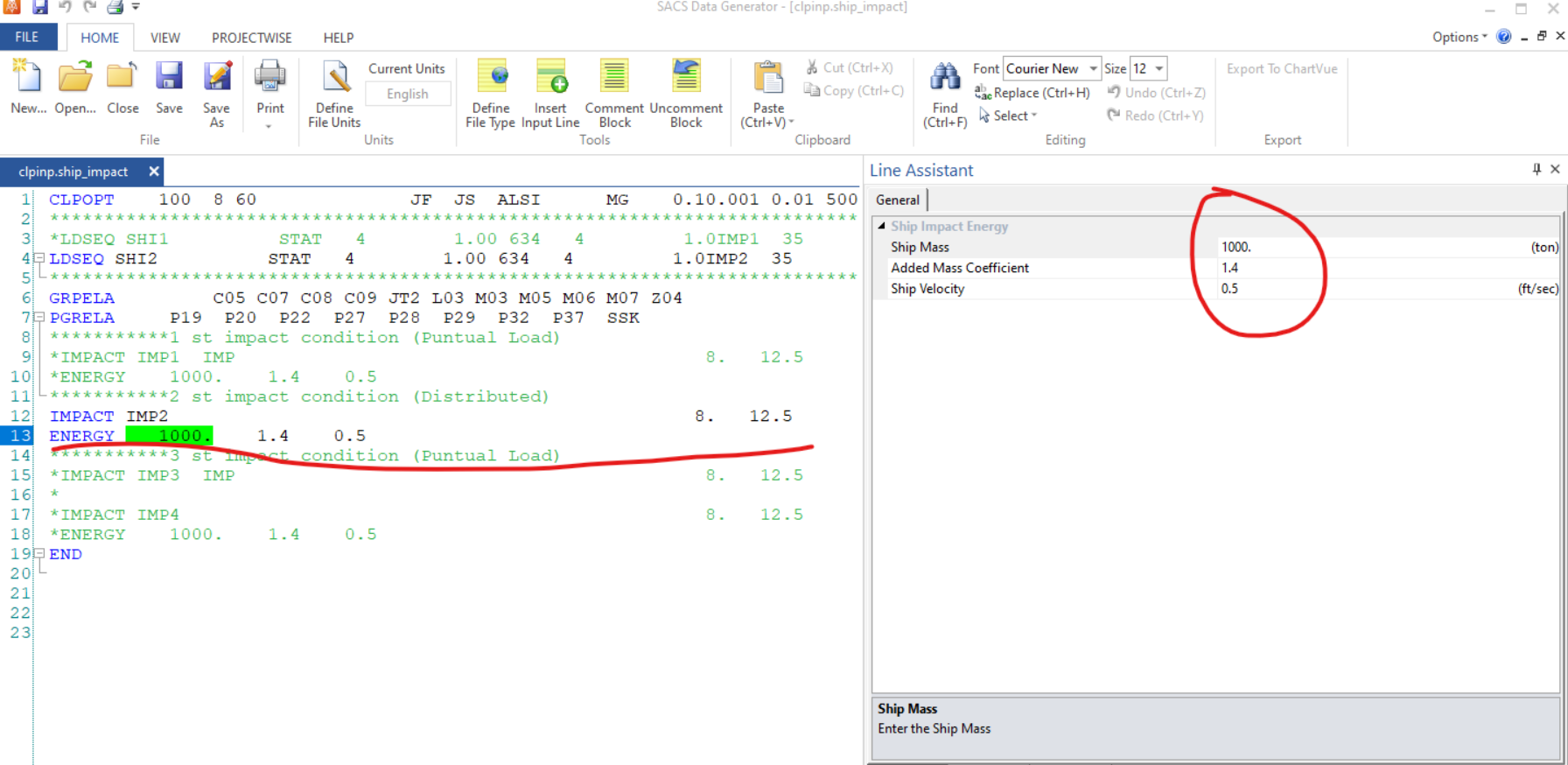

You can set 1000kN or 10000kN whatever value that you want, remember that this load will be applied graduated and the process will stop at the moment in which the structure absorbs 100% of the energy of the ship, doesn't matter if you set as an initial load 10 000 kN the, in this case, the process will stop near of the 900 kN load applied, the total energy that the structure shall absorb will be calculated with the parameters given in the card ENERGY
