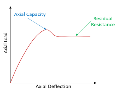

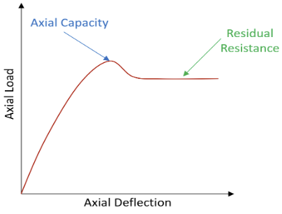

When pile-soil interaction is modeled using Winkler soil springs, the axial behavior of a pile typically follows a load–displacement response curve. The pile capacity reported by SACS corresponds to the peak of this load–displacement curve:
If the pile head is gradually pushed or pulled, the axial load increases with displacement until it reaches this peak capacity. After the peak is exceeded, the following behavior may occur:
During a Collapse analysis, when the pile displacement passes this peak point, the pile is considered to have entered the post-capacity region of the load–displacement curve. At this stage:
The SACS warning “Pile Nearing Punch Through” is generated to notify the user that the pile has passed, or is close to passing, the peak of the axial force–displacement curve. This indicates that the pile is entering a region where punch-through or pull-out behavior may occur, and the results should be reviewed carefully.
It is important to note that pile capacity depends only on the axial displacement response, while pile plasticity depends on the combined loading applied at the pile head, including Axial load, Lateral load, and bending moment. For example, a pile carrying an axial load below its axial capacity may still become plastic if large lateral forces or bending moments are applied at the pile head.
Therefore, a pile may first reach its compression capacity, and as the analysis progresses and large deformations develop, additional lateral forces or bending moments may be induced, which can lead to plastic behavior of the pile (pile plasticity).
This warning serves as an indicator for further investigation of the pile response in the collapse analysis.
