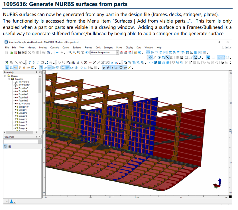

Why cannot I export Structure Parts to Rhino in v23.07?
In the 23.07 version, it is possible to create meshes from parts. It gives more control because the user can make sure meshes are correct or refined before exporting.
In order to export Structure Parts to Rhino you need to mesh the parts first or create NURB surfaces, and then export a normal model.
