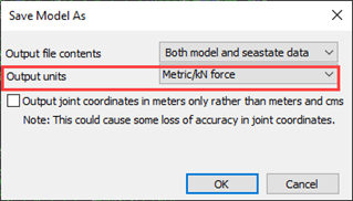

1. Close all instances of SACS.
2. Open SACS model in Precede.
3. Go to File > Save As
4. Choose the required output units to be saved in a new file > OK
5. Give a new sacinp.xx name for the model > Save.
