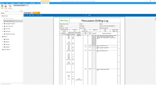

This article will explain how to produce a log report that comprises multiple locations and report templates into one output.
What do I need to know to produce this?
- How to login to OpenGround Cloud
- Device Authentication (.net SDK & WebAPI)
- User Authentication (WebAPI)
- Windows Provider Authentication (.net SDK)
- Query which Project the location I will query against is in
- Query which locations I will produce the document against
- Query which log report profile is to be used
- Create a log report
- Download a log report file
