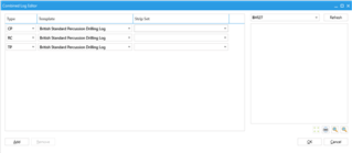

- You will then have a "Template Setup" window appear.
- Please review the settings there to get the template sizes you wish. Following this you will get a "Combined Log Editor" appear.
- In this window use the "Add" option to add all the templates you wish to combine. Select the "Type" (location type) and the template you wish to use for that location type. It is also possible to choose different strip sets if your templates are Mater Templates with different strips available on them. Repeat this for each location type you wish to include on the combined log and then select "ok"

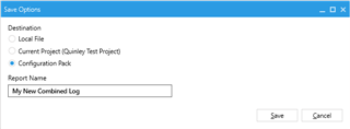

- After selecting "ok" you will be asked to save the template, please save the template to the configuration pack or project and give it a name you will recognise later.
- The Combined template will then be in the configuration pack ready to use in OpenGround.
