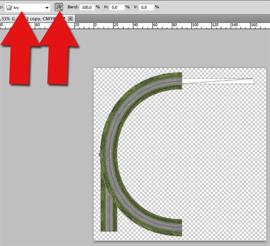

14) Copy the layer and press ctrl-t. Go to warp modes and set warp on Arc (see image). Drag the little square in the middle to the left until it fits in the curved part.
15) Repeat step 13 and rotate it 90 degrees. Position it next to the curved road. You should see something like the image below. Go to File and Save the image as a tif, png or jpg image.
