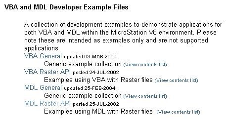

Bentley Developer Support
The Bentley Developer Support Group assists users with programming issues and questions. The programming languages currently supported are MDL, VBA, JMDL, and MicroStation Basic.
Bentley Developer Support is a great resource if you are having a logic problem or if you are trying to use an object that is not working as you expected. You can find examples created by the Developer Support group on MicroStation on the Web. They are located in a downloadable zip file called VBA General (V8VBAExamples.zip) located on the site's utilities page. It is accessible only to users who have a valid login and password. Scroll to the bottom of the page and you will see information about accessing these examples (Figure 4).
Figure 4.
The VBA General zip file contains various VBA examples that can do a multitude of things. These examples are updated regularly. When you download the V8VBAExamples.zip you will notice that there are no compiled *.mvba files, only the source *.bas, *.frm and .cls files. After the zip file is downloaded you will need to unzip it into a folder so that the sub folders for each example are also created, create the VBA Project (*.mvba) for the example you want to use, then import the source files into it.
There are a number of useful utilities on this Web page in addition to the VBA examples. It would be a good idea to download those utilities that may improve your workflow.
