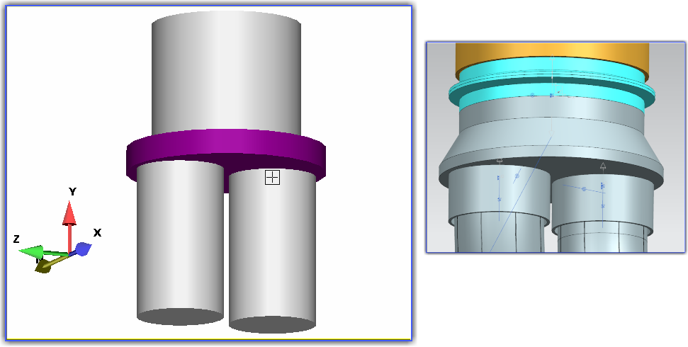

How to model a modified Y-pipe fitting?

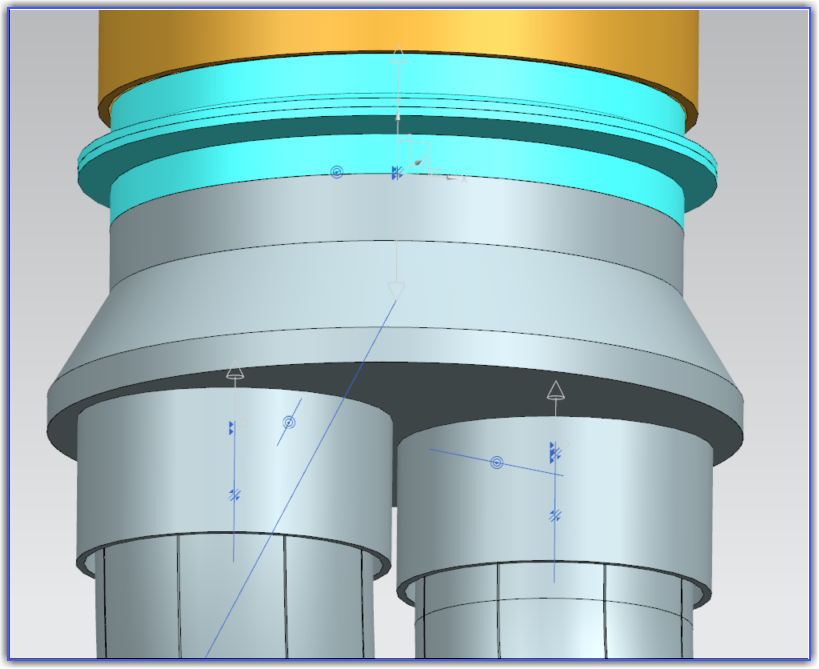

Using the Same techniques to create a Nozzle on a Vessel, create the modified Y-pipe fitting
1. Starting from some point on the main vertical piping, insert a run in the vertical direction to a short distance away from the end of the Modified Y connection (ex. A00 to A01 = 1 ft)
2. Continue the vertical piping as need to the starting point of the Modified Y component. (ex. A01 to A02 = 8 inches)
3. Insert a new pipe property that has the same Outside Dia. of the Modified Y component (ex. Y-fit, Material = same as main header)
4. Insert run piping to represents the same thickness as the Modified Y component (ex. A02 to A03 = 4 inches)
5. Insert weight of Modified Y component
6. Keeping with the same techniques used to mount a nozzle on Vessel, insert internal piping to rigidly mount branch piping on surface of the Modified Y component.

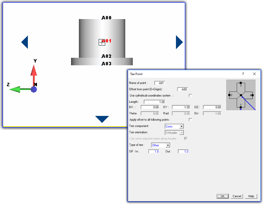

a. Make the previous point on the main header the active node point. (ex. A01), and Modify / Convert point to Tee.
b. Double select the node point (ex. A01), a tee dialog will now appear. make the following changes:
- Change Tee Component from Tee to Cross,
- Set Type of Tee from Welding to Other
- Enter SIF - IN / OUT = 1.00

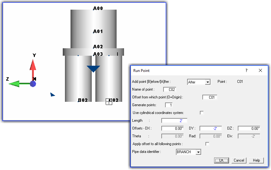

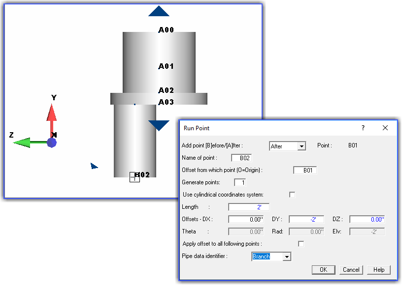

7. Insert Branch piping with new PipeID as needed (ex. B01 to B02), Insert new pipe property to represent smaller piping out of the Modified Y component (ex. PipeID = Branch)
Done with Branch #1, now go back and insert Branch #2.
8.  Go back to Cross and select 2nd branch arrow, again notice that the segment has been changed to a new value (ex. Seg B to Seg C)

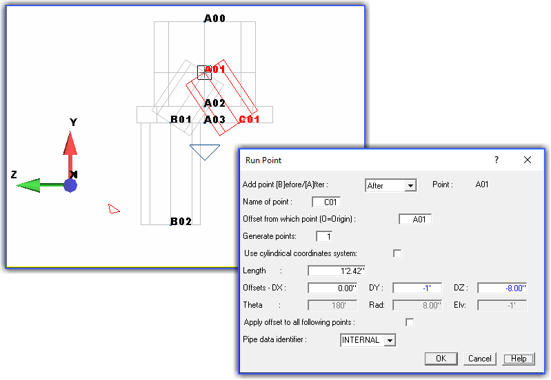

a.  Insert run piping to surface of Modified Y component using the correct PipeID (ex. C01  Dz = -8 inches, Dy = -12 inches, set Pipe data Identifier = Internal)
9. Insert Branch piping as needed using the correct PipeID. (ex. B01 to B02, Dy = -2 feet, Pipe data identifier = Branch)

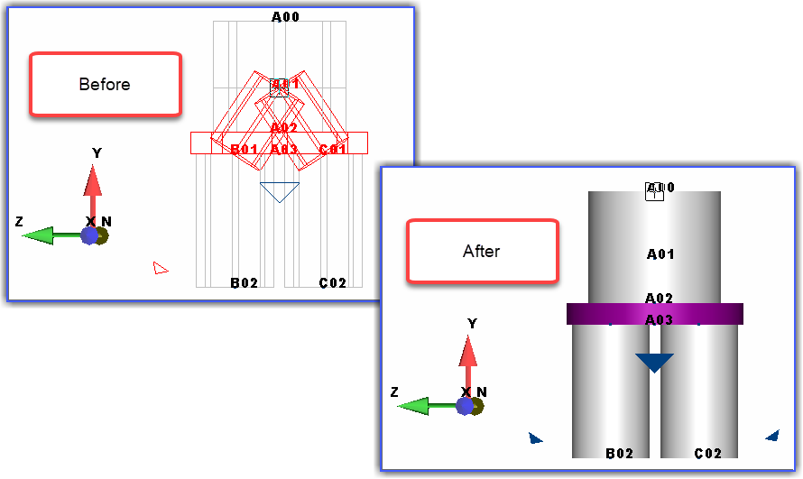

10. Select all the Internal Piping and piping representing the Modified Y component (can be done in one step using the Input grids Pipe Property Tab), these items should all be highlighted Red. Insert Rigid Options Over Range,
- Include weight = disabled
- Include Expansion = enabled

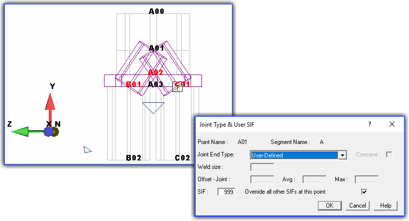

11. Last step, select all weld locations (ex. A02, B01, & C01),
- Insert Joint Type and User SIF, Joint End type = User-Defined
- SIF = (user to calculate and enter value),
- Override all other SIFs at this point = enabled
