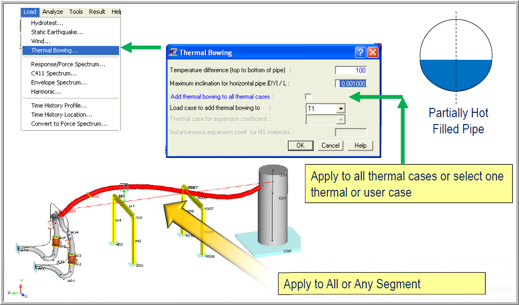

Partially Filled Liquid Pipelines or Hot Sun Exposed Pipes, see Example Model here.
The Load/Thermal Bowing command (first added in AutoPIPE 08.09.00.14) enables the user to calculate thermal bowing separately or included with all or one thermal load case which can cause severe stresses on the piping. Thermal bowing typically occurs when transporting fluid on a partially filled pipe but can also occur in exposed pipes in hot climates where one side of the pipe is exposed to the sun and the other side is in the shade.  In this case, the top and bottom of the pipe section can experience a significant temperature differential. This temperature differential causes pipe thermal strains which produce pipe curvature.
To simplify the problem, AutoPIPE assumes a linear thermal strain distribution across the pipe. With this assumption residual stresses vanish and only pipe curvature stresses exists.

How can I apply thermal bowing on only Static Analysis set #3?
When i check the thermal bowing option for analysis set 3 it is also checked for the other analysis set. this occurs in spite of the fact that i specified : apply thermal bowing to thermal case T2 only in thermal bowing definition window.
Answer:
At this time, Thermal bowing is applied to all Static Analysis Sets. It is associated to one or all thermal load case based on the "Add thermal bowing to all thermal cases" setting. If unchecked, the user will have the option to specify a single load case for which thermal bowing effects will be added (if thermal bowing option is checked in the static analysis).

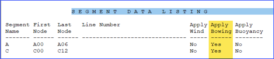

Also, check the model input listing, Segment Data Listing sub-report to confirm if Thermal bowing is applied:
