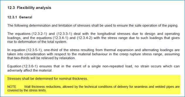

Q3. For Stoomwezen this setting is off by default and for EN13480 it is on by default. Is this difference in default settings a code requirements or not?
Answer:
Each piping code has requirements for what wall thickness would be used in a specific calculation. The CAE development team automatically adjust many default setting based the piping code selected. In this case, please see the following AutoPIPE help section:  Help > Contents> Contents Tab> Reference Information> Code Compliance Calculations> En1380 and Stoomwezen,
Stoomwezen:
Stresses Due to Sustained Loads (STOOMWEZEN)
Noticed that the value tred or corroded thickness is used. Another words "Use nominal wall thickness" by default should be OFF .
En13480:
Stresses due to Sustained Loads (En13480 - 2012)
Notice that the value en or nominal wall thickness is used. Another words "Use nominal wall thickness" by default should be ON
Again default setting are usually based on code requirements.
