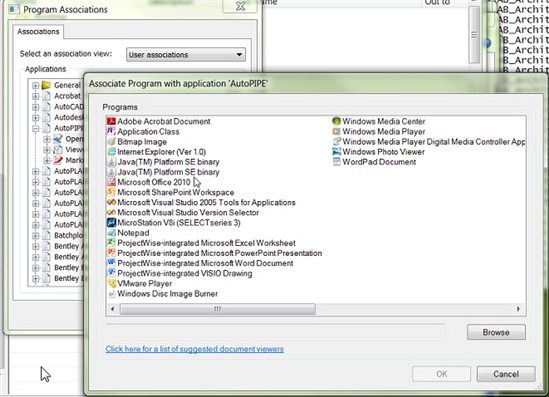

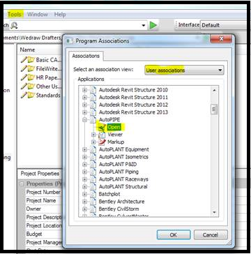

Log into the data-source in ProjectWise Explorer.
With the program running select Tools> Associations> Programs...> Change "Select an Association view:" from  "All Associations" to "User Associations",

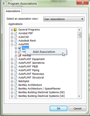

Then in the program listing find AutoPIPE, press the "+" to expand the menu, press on "Open", again press "Add Association",
Finally select AutoPIPE from the program listing provided:
