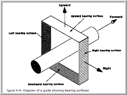

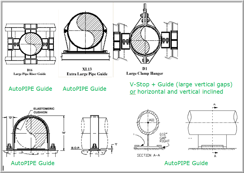

Real-World Guide Supports
Typical Guide Supports

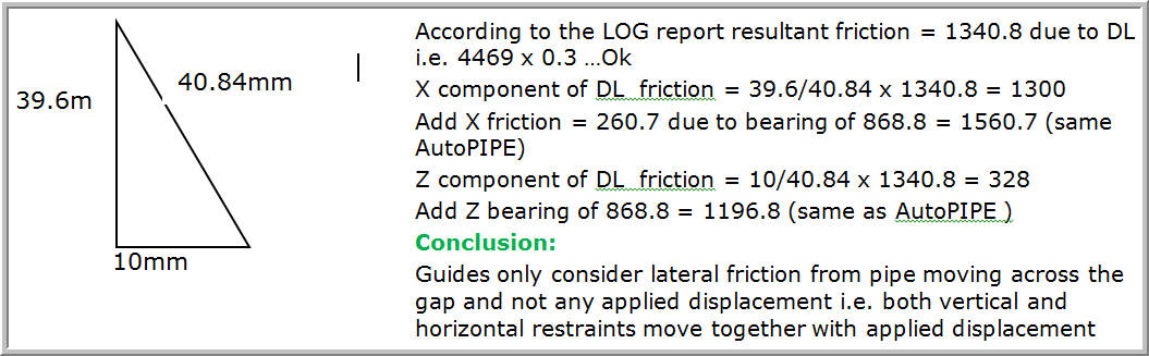

AutoPIPE Guide
All four bearing surfaces behave as integral but with independent bearing springs upward and laterally

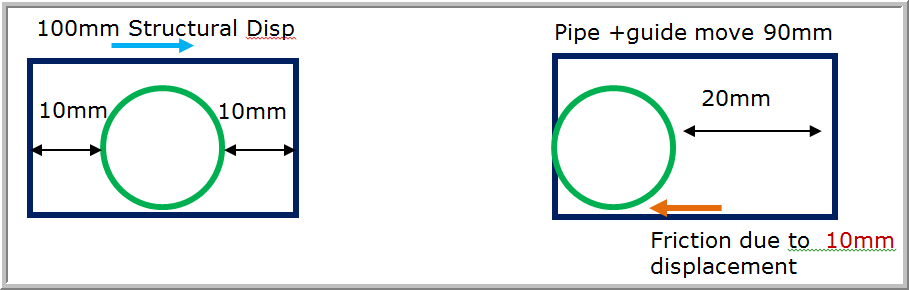

Guide Explained
Friction calculated on the vertical bearing spring is 10mm lateral movement i.e. gap. This is a more typical real-world guide.

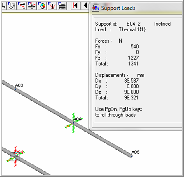

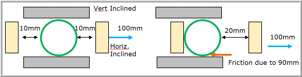

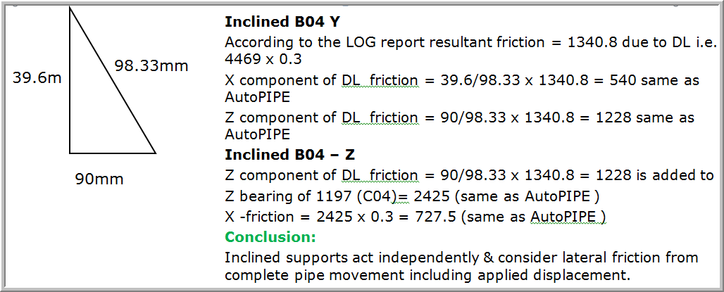

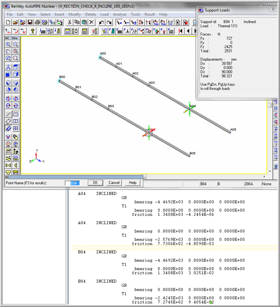

Two(2) Inclined Supports Explained
Friction calculated on the vertical inclined based on 90mm lateral movement of the pipe NOT modeling a real-world guide

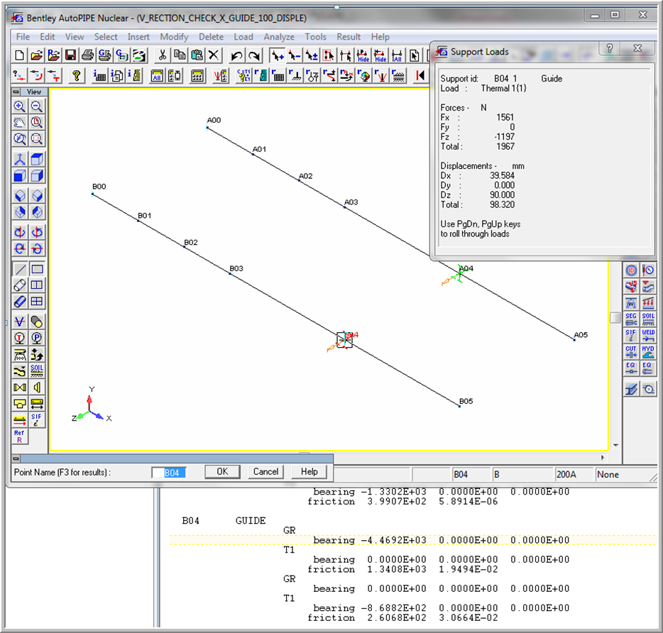

SHOW CAESAR GUIDE AND RESULTS
Segment B same as Segment A except 10mm gap left / right
