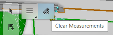

Dimensions are temporary to the session and can be cleared from the view by Selecting from the Tool Palette  or shared (not working)
