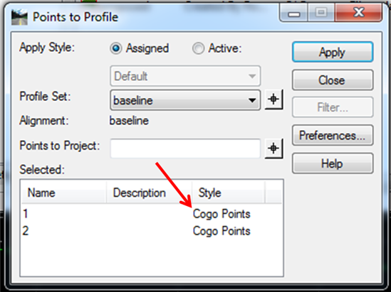

  3. The Point Symbology that is associated with the Cogo Point must be set up correctly so that the points are displayed.  To double-check this:
  1. Note the style that is currently associated with the Cogo Point.  You can find this in the Points to Profile dialog box:

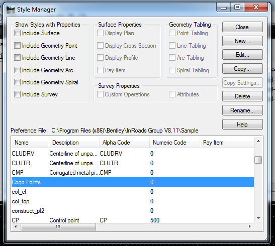

  2. Go to Tools > Style Manager and locate the style that is assigned to the Cogo Points.  Highlight that style and select Edit.

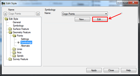

  3.  Navigate to the folder Edit Style > Geometry Feature > Points > Symbology.  Under the Symbology on the right, select Edit.

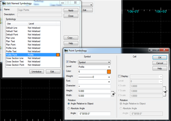

  4. On the Edit Named Symbology dialog, highlight "Profile Point" and select Edit.  Ensure that either
     a Symbol or a Cell is toggled on.
