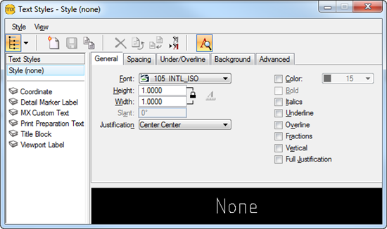

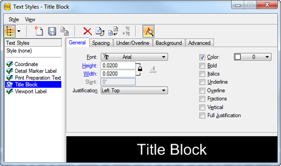

  3. With the file open go to Element>Text Styles.

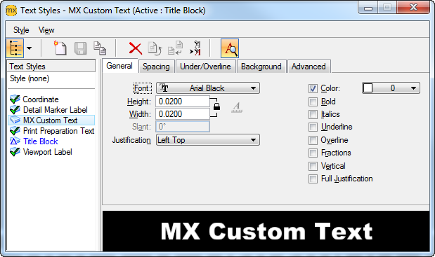

  4. Add the custom test styles are required. As an example I created MX Custom Text
  5. Close the panel when you have added the text styles you require and go to File>Save. Exit the software
  6. Re-open MXRoad in a project and go to Element>Text Styles. You will see that the custom text styles are now part of the default styles in MXRoad.
