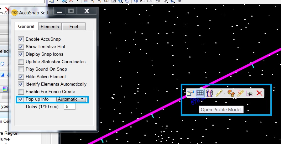

OpenRoads Pop-up menu setting
 Product(s):Bentley MXROAD
 Version(s):08.11.09.493 SS3
 Environment: N/A
 Area: Settings
 Subarea: Pop-up Menu
 Original Author:Amita Shinde, Bentley Technical Support Group
In order to turn off/on the pop-up menu, the setting is found in CAD menu, "Settings > Snaps > Accusnap". Uncheck the option "Pop-up Info" in the "AccuSnap Settings" dialog box, in order to disable the pop-up options.
