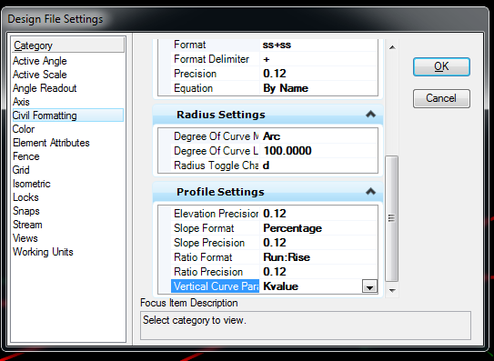

First, you will need to set the Vertical Curve Parameter to "K Value":
  1. In the MicroStation menu, select Settings > Design File > Civil Formatting.
  2. In Profile Settings, set the Vertical Curve Parameter to "Kvalue".

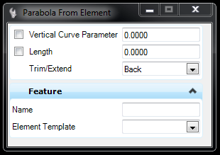

Now, when you create your vertical curve, enter the K Value as the Vertical Curve Parameter:
