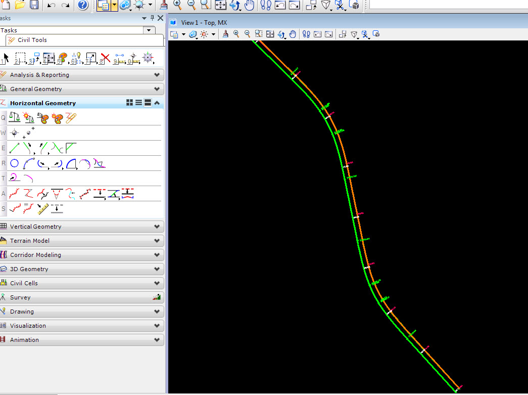

1. Create a Master Road Centerline using Quick Alignment with Vertical Design.
2. Offset from Master Centerline to Side Road through Design > Design a String > Horizontal Offset then convert Side Road to a 6D master string. (Modify > Edit Strings > Convert to a 6D master string).

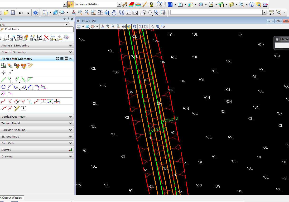

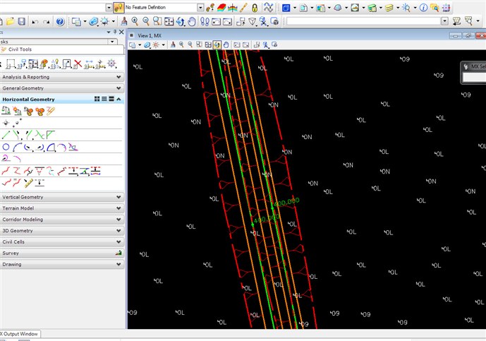

4. Design Carriageway and Earthwork for both Master Road and Side Road Separately. As shown in the below snapshot the two embankment are crossing each other.
5. Create a triangulation of the Master Road including the earthwork and create a separate triangulation of the Side Road alignment including earthworks.

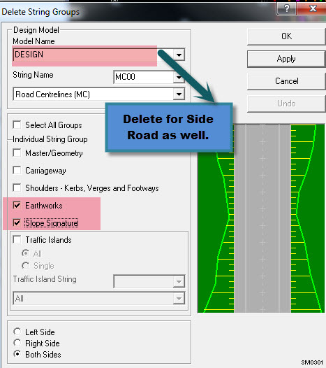

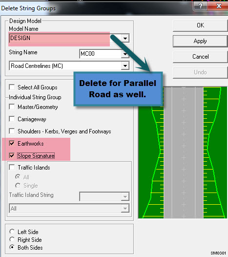

6. Delete created earthworks for both Master Road and Side Road using Modify > Edit Strings > Delete Strings Groups as shown in the below snapshot.

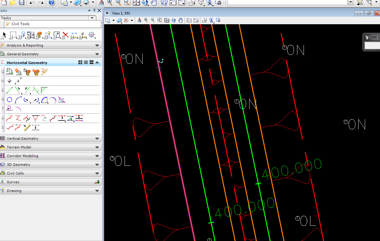

7. Regenerate the Master Road Earthwork wizard to a triangulation of Parallel Road and Regenerate the Parallel Road Earthwork wizard to a triangulation of Master Road. You will see the Embankment of two Roads are not crossing to each other.
Note: While regenerating the Earthwork Wizard for Master Road please make sure parallel Road model should be selected as a triangulation model and for Parallel Road make sure Master Road model should be selected as a triangulation model.
