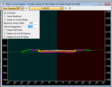

Question:
Where can you change the vertical exaggeration for the Cross Section Viewer in the SS3 OpenRoads product?  There is not an option in any command settings to set this before it is generated.
Answer:
Once the Cross Section View is created you can change the exaggeration of the view by clicking down arrow on the View Properties > Vertical Exaggeration and set the value you wish to exaggerate the display for that particular view.
