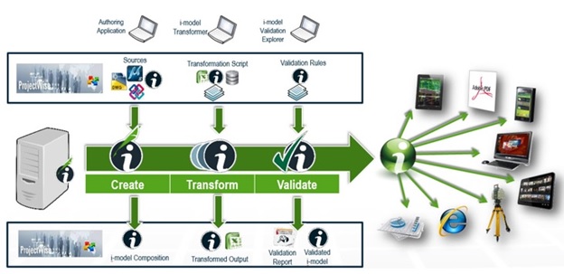

The following diagram shows how iCS for i-models orchestrates the functionality of Transformation Services, thereby integrating it with the ProjectWise managed environment:
NOTE: Validations are defined and executed in transformation scripts using a Validation transform.
iCS for i-models accomplishes this by:
  1. Publishing source documents out of ProjectWise as i-models to be transformed.
  2. Staging those i-models (and other files) for i-model Transformer to operate on.
  3. Performing i-model Transformations and Validations.
  4. Storing the transformed and validated content back in the managed environment of ProjectWise.
