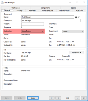

- Check which ‘Application’ is specified to be used for opening the file
- Right click on the file and choose Properties. On the General Tab, check the application that is set for this file.
Figure 1. Application configured to open the file

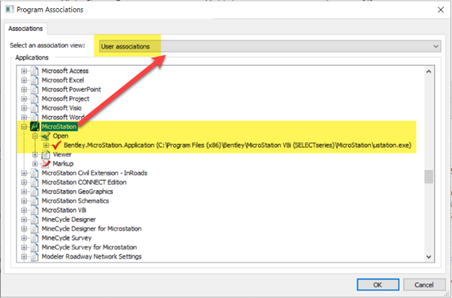

- Sometimes there will be a user defined association causing conflict. Check to see if there is a user defined program association.
- In Projectwise Explorer go to Tools > Associations > Programs.
- Changed the ‘Select an association’ view to “user associations”
- Find the application in the list and expand it
- Click on the ‘Open’ option.
- If there is a path indicated, then there is a user association. To remove it, Right click on the path and choose un-associate.
- If no path is indicated, then there is no user association
Figure 2. Custom user association

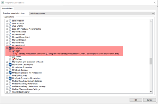

- Check the Global association
- Changed the ‘Select an association’ view to “Global associations”
- Check that the path is pointing to the desired application.
- Note you can also check this in Projectwise Administrator via the Application node and make changes if necessary.
Figure 3. Global association
