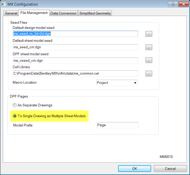

This is the workflow for creating DWG files with the design elements (alignment model, survey model, long sections, cross sections) in Model space and the Sheets in Paper space populated using viewports. This process works for Plan Drawings, Long Section Drawings and Cross Section Drawings created using Final Drawings.
  1. Set DFP pages to be Single Drawing under File Management.

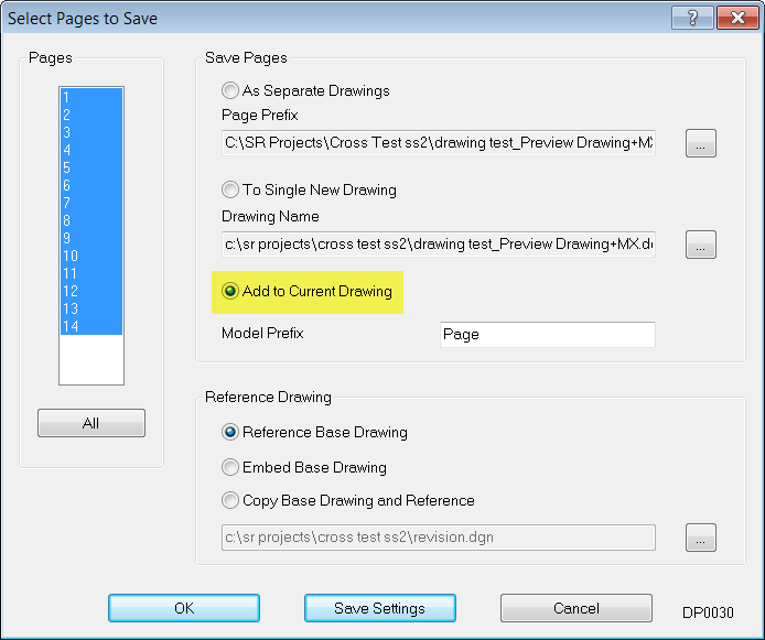

  2. When Selecting Pages to Save select Add to Current Drawing.
  3. Follow the process shown in the video below to create the DWG file.
