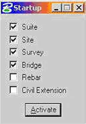

When you choose GPK_STARTUP_CONFIG = 1, an item will be added below "Activate GEOPAK" called "Startup Configuration." When selected, it will give you a dialog with all installed products displayed in black and those products that are not installed ghosted out. You can then check the desired products you want to use. Note: "Suite" in the dialog refers to the "ROAD" pull down. The program will select the minimum license use depending on what has been checked off.< /FONT >
Example:
In Figure 1, a Suite license will be used and you will see all the Suite tools in the Applications pull down.

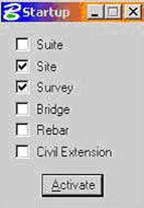

In Figure 2, a Suite license will be used and you will see all only the Survey and Bridge tools in the Applications pull down.

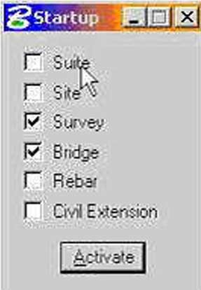

In Figure 3, a Site license will be used and you will see all the Site tools in the Applications pull down.
To allow the functionality, this variable should exist and be set to "1." No other setting is applicable. The settings will be remembered for subsequent MicroStation activations.
