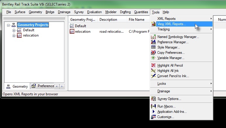

Did you know that you can create reports using data from your InRoads preference file (*.xin)?
- In the InRoads Explorer, go to Tools>View XML Reports to open the Bentley Civil Report Browser.

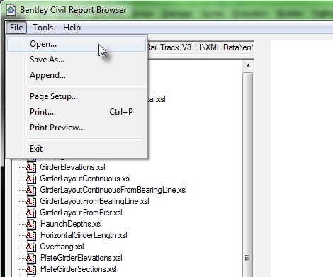

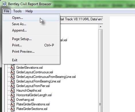

- In the Bentley Civil Report Browser, go to File>Open.

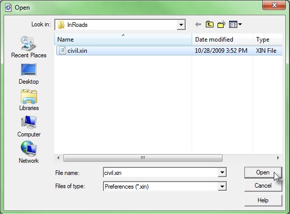

- Change the Files of type to "Preferences (*.xin)" and open your preference file.

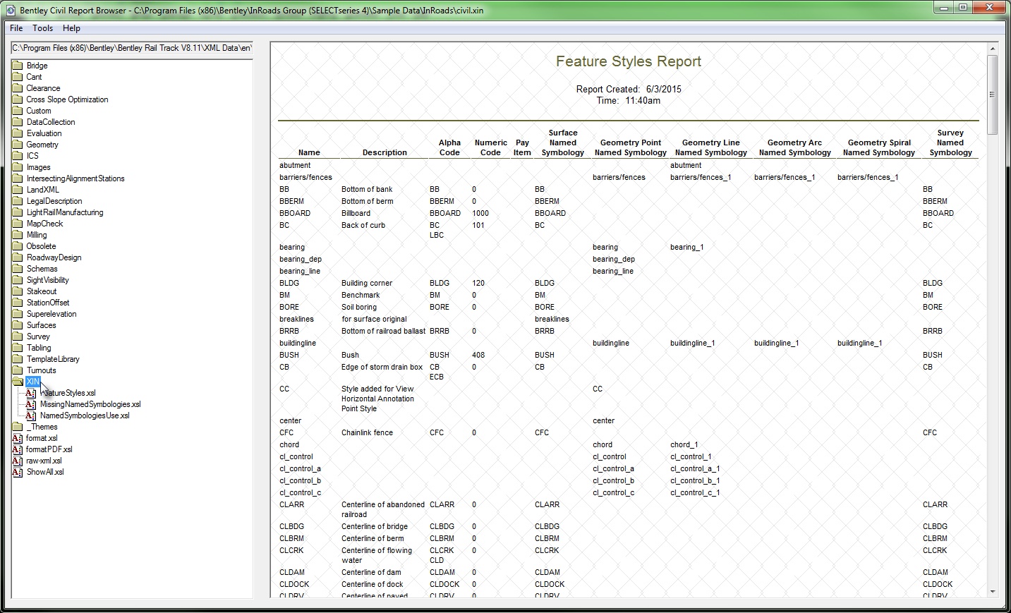

- In the left pane of the browser, locate and open the folder, XIN. There are three XSL files provided which report on different aspects of the preference file.
