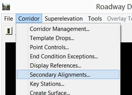

Secondary Alignments are set in one of two places:
1. In the point control dialog, the user can toggle ON or OFF the Use as Secondary Alignment for each point control
2. In the Roadway Design, they can select Corridor>Secondary Alignments and add chains to the list.
