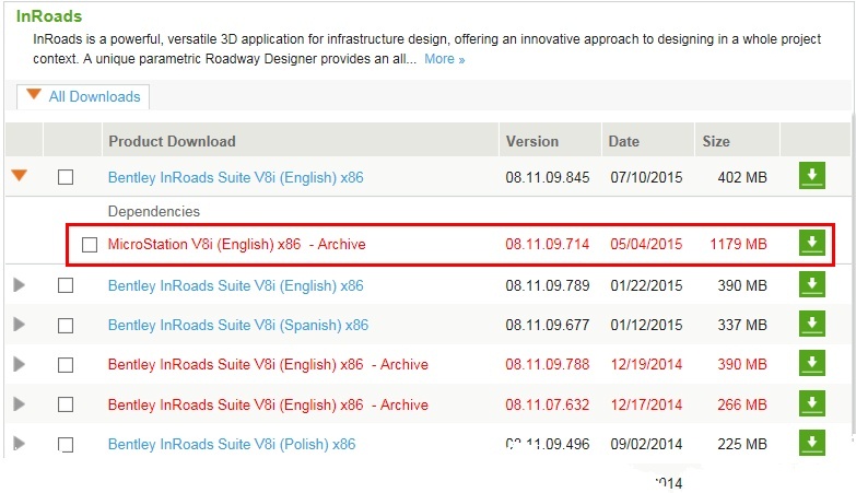

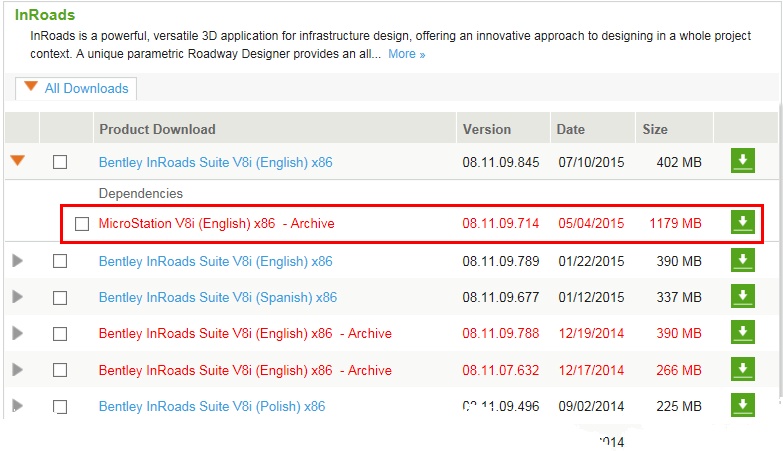

Where do I download MicroStation version 08.11.09.714?
Answer:
The 08.11.09.714 version of MicroStation was compiled specifically for the 08.11.09.845 versions of GEOPAK/InRoads/MX. The best way to access and download MicroStation from Bentley's SELECTServices site is to search for the 08.11.09.814 version of the civil product and download it with its dependent version of MicroStation as Shown below:
