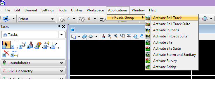

Question :
When trying to install Bentley Rail Track on the system that already has InRoads installed, unable to get BRT loaded.
Answer :
When InRoads Suite is installed, you can access Bentley Rail Track as well without a separate BRT installation. For this, you can start Microstation standalone, and go to "Applications > InRoads Group > Activate Rail Track".
If you don't have the "Applications" menu when you start Microstation, follow the steps below to load the option:
1. Create a new text document at C:\Program Files (x86)\Bentley\MicroStation V8i (SELECTseries)MicroStation\config\system.
2. Name the file LoadInRoads.cfg and say Yes if it prompts you to change the extension.
3.Then open that textfile and copy in the following:    Load_InRoads_SS2=1
