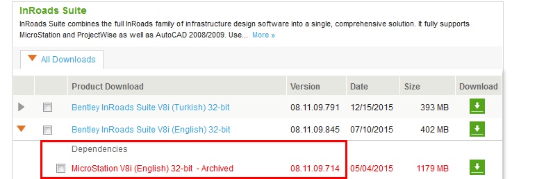

Until its release, you can install both MicroStation CONNECT and a previous MicroStation version on the same machine. To insure compatibility, please install the MicroStation version that is listed as a prerequisite for the civil product you wish to install.
For example:
