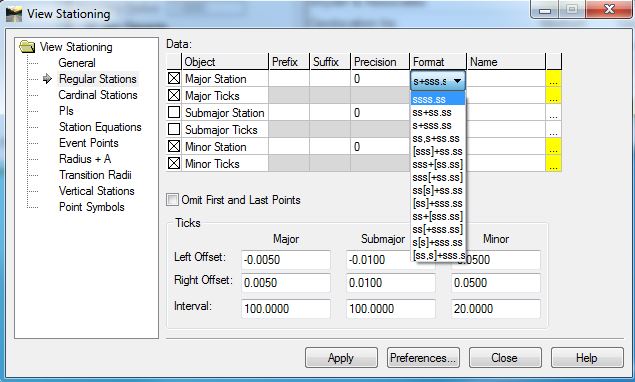

The general setting for station format is located under File > Project Options > Units and Format.  This value specifies the station format used when alignment stationing is displayed in dialog boxes and in the drawing file.
Many commands allow this format to be overridden for that individual command.

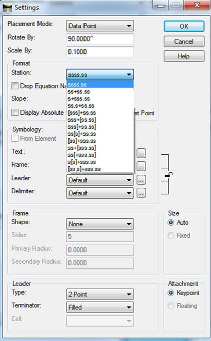

Under the View Stationing command it is under each different data type branch (General, Regular Stations, Cardinal Stations, etc.) where you can adjust the format.
For the Drafting Notes, you select the 'Settings' option on the right to access the format options for the notes.  You can adjust the Station formatting in the same manner.
