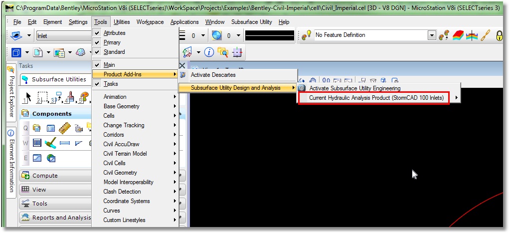

The Bentley Subsurface Utility Design and Analysis (SUDA) tools that are included in most OpenRoads packages include the "StormCAD 100 Inlets" functionality at no extra charge. It is included for all packages of GEOPAK, InRoads, or MX which contained a drainage design product in SS3 or previous versions.
With the exception of PowerSurvey, products which do not include Subsurface Utility Design and Analysis free of charge can activate it using StormCAD licenses; however, the minimum level of hydraulic design capability is StormCAD Unlimited. Usage will be charged against a StormCAD license. If you do not own a StormCAD license, overages will accrue.
