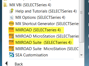

  2. Check shortcut of MX Road Suite, MXRoad or both activated on the desktop or under Start > All programs > Bentley

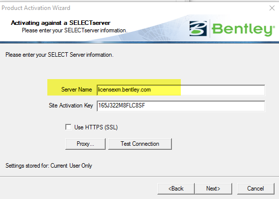

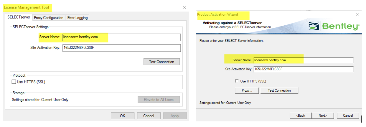

  3. While activating licenses through Tool > Product Activation Wizard > Server Name should match with the document received by you from the Bentley Systems analyst.
  4. Same Sever Name should be entered under License Management Tool when you select Tools > Options & Tools > Product Activation Wizard.
  1. First Activate the license through Start > All programs > Bentley > MX Options > Licensing Tool and If you launched MXRoad Suite or MXRoad, go to File > Cad Menu> Utilities > License Management Tool.
  2. Create Shortcut for MXRoad Suite or MXRoad or both, go to All programs > Bentley > MX Shortcut Generator, select MXRoad Suite or MXRoad or Both.
  3. If you require only MXRoad Suite not MXRoad then first you need to create shortcut for MXRoad Suite and then after only MXRoad Suite seems to be activated under License Management tool.
  4. If MXRoad seems to be activated under License Management Tool and if you require MXRoad Suite instead MXRoad, then delete Shortcut of MXRoad from desktop and create Shortcut for MXRoad Suite.
