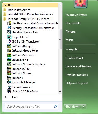

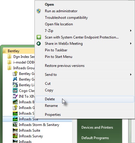

  1. Delete the unlicensed products from the Windows Start menu.

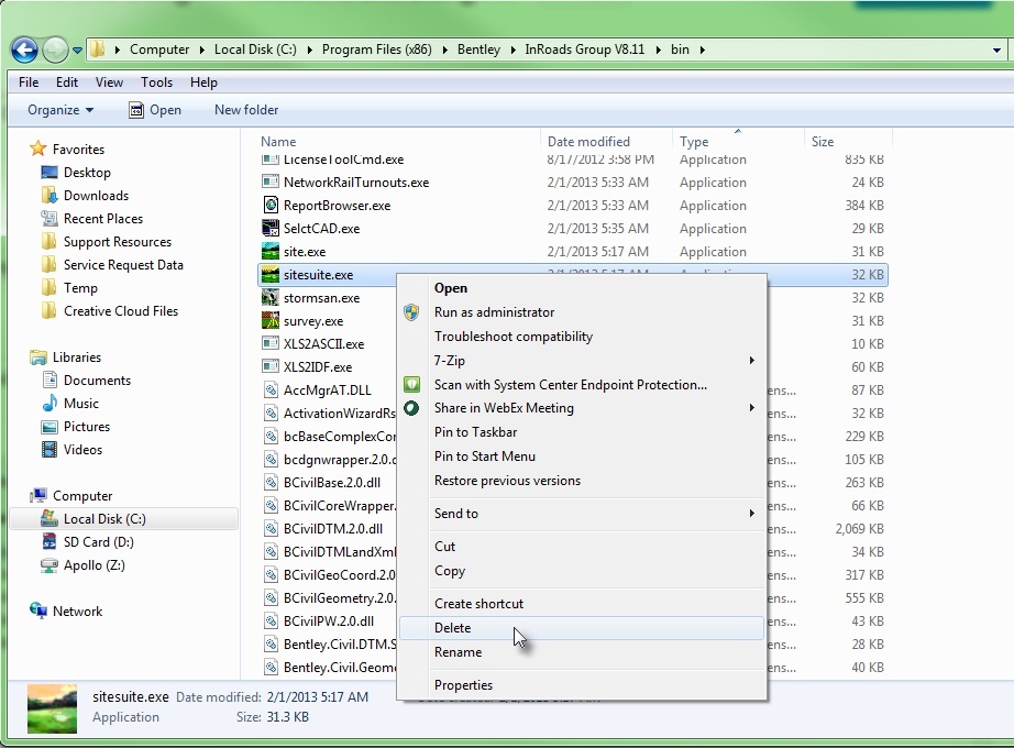

  2. Locate and delete the executable file.
