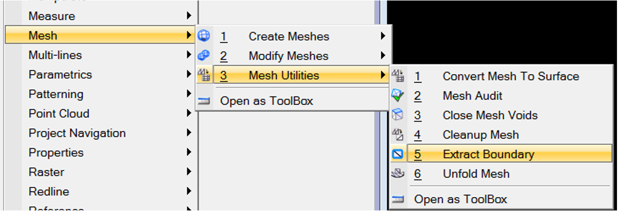

Question:
How can I extract the boundary of my corridors to produce a construction limit or footprint of my road design?
Answer:
- Set the design stage of the corridors to one that creates the corridor top mesh.
- Within the Default 3D model, create a selection set of the corridors you want to include as the construction limit.
- Go to Tools > Mesh > Mesh Utilities > Extract Boundary
- Data point to accept to extract boundary from mesh elements.
- If you selected multiple corridors, you may need to trim the overlapping boundary lines. You can use the Trim Multiple MicroStation tool found from going to Tools > Manipulate > Modify > Trim Multiple.
