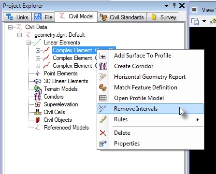

Question:
How do I remove intervals from civil geometry elements?
Answer:

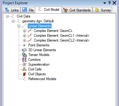

Locate the civil geometry element in Project Explorer>Civil Model. There you will see the name of the original geometry element as well as any intervals.
Highlight the name of the original geometry element, right-click to display the pop-up menu, and select Remove Intervals.
