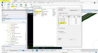

Can we edit conduit dimension for Open Drain as we don’t see conduit table under properties tab?
Answer:
To edit conduit dimension for Open Drain, go to Subsurface Utilities > Catalog > Conduit Catalog to change the dimension of the Conduit.
