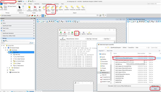

Our company uses a trimble data collector, so we pull our results into a .csv file. I am having trouble finding anything that helps me with importing a .csv file into OpenRoads Designer CE. Is there a way ORD can read in a .csv while still keeping the point names connected to the points? I can "import coordinates" on ORD, but then I have no idea which points which are
Answer:

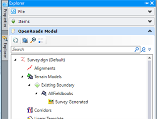

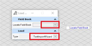

With OpenRoads Designer Update 3 and beyond, you can import your CSV via the Survey Workflow.
Review Survey
Review Terrain
